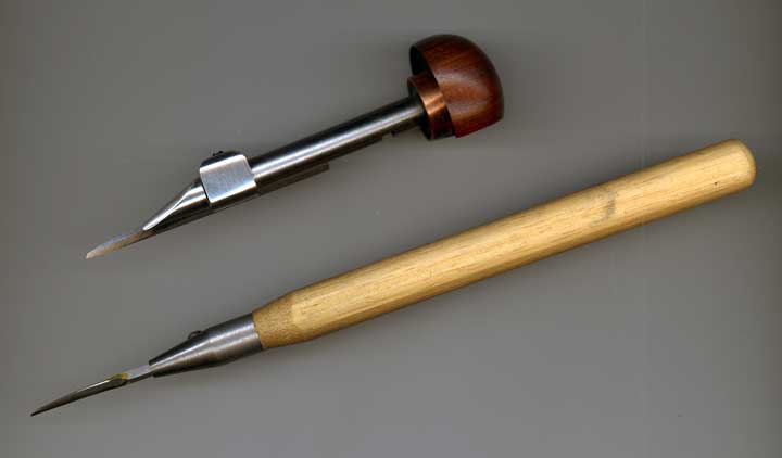

Thank you for your responce in regards to the bulino art. It will be quite awhile before I ever am engraving bulino scenes like that. I still dont understand the different degrees of the faces on those tools. How do you achieve those different faces on your bulino tools? Hand held? Do you use the GRS tool holding devises?

I'll try to answer your question about my tools. I sent Bill a scan of my two bulino tools and hope that he will post them for me. Elk season starts here tommorrow and I'm running around like a chicken without a head trying to get every thing together. Hopefully I can type this with some sort of intelligence while my mind is someplace else.
The first tool I use is my line tool which is usually a 70 degree V tool. By that I mean 70 in cross section like a 90 or a 120. The face angle I sharpen to usually a 50 degree angle with a 15 degree heel. The heel is small and runs up the total length of each side. The handle is made by Ray LeTourneau. I like these as I can get a good grip on them with my fingers. The other long handled tool is the one I use for poking or making dots. It too is usually a 70 degree tool and this time I have anywhere from a 40-50 degree face with no heel..I want this to go straight into the metal. I hold it sort of like a pencil and rest it on my left thumb to help me guide it along as i poke.
For sharpening I really like the GRS Dual Angle fixture. It's easy to use and consistant. I usually sharpen the face 1st to a 50. To make the 70 graver I grind each side with a 55 degree rotation setting . This will leave me with a 70 degree tool. To grind my heel I set the rotation angle to 35 and just brush it over my 1200 wheel lightly. Hope that helps you out and hope I made sense in my pre hunting season haste. I'll try and check back quickly tomm night.

Here is the photo you sent showing your tools mentioned above.
Posted by Bill Gamradt  at 10/21/2006 1:44:40 AM.
A more detailed view of the tools.
Posted by Bill Gamradt  at 10/21/2006 1:46:08 AM.

The long white handle....Is it one you've made yourself?
When your putting the dots in...do you try to keep the work facing the same direction all the time so that the dots are also consistant....Or dosn't it really matter.

The straight handle is something I bought a number of years ago but it is super easy to make. It's nothing but a hardwood dowel with a hollowed out tip you can make. It has a allen set screw to hold the graver in place. I do my poking from all different directions and combinations to give me different effects. When combined with lines the textures can be quite varied for the good of the image. This is not stippeling as OI am not going straight down into the metal as I would for backgrounds between the scroll leaves. When I poke, I am also doing this in a definate pattern according to the contours of the image.
If you have some of the NgravR Belgium Chasing Handles you can use those also for poking. You might evenlike the square shape as opposed to round. You can also make these out of square stock. Hope this doesn't confuse you.
