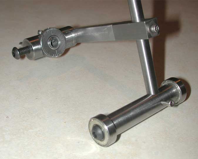

Just thought I'd send photos of the engraver shapening fixture I made from the photos and plan in the last Engraver magazine.
I'm new at this and am getting the tools together to get started and this is the first one I've made.

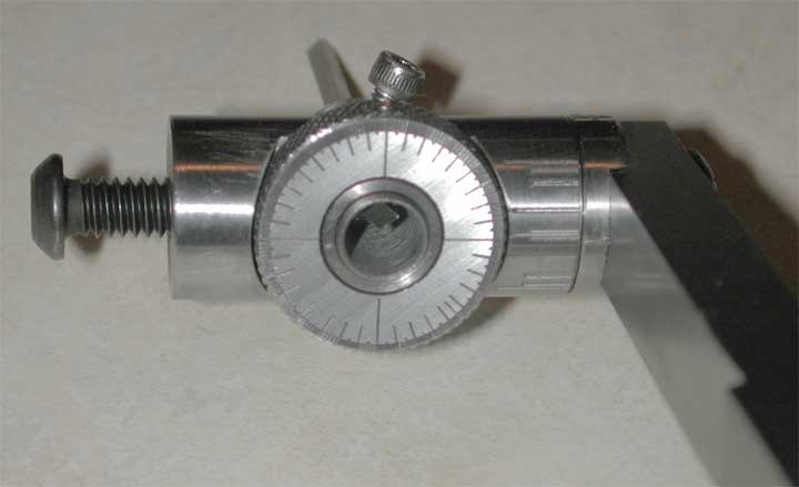

I engraved the holder for both roll and pitch so it can be adjusted to any needed angle.
Hope the photos are OK.

Another Photo
Posted by James Wright, Jr.  at 3/3/2008 10:56:20 AM.
Hi Jim, and welcome.
You did a great job on the fixture, congratulations.
Hope to see a lot more of your work in the future.
Best regards, John.

James,
Good to see you making the tool. I can't see if you have the flat milled on the upright post from the base on the back side. This is important to keep the front parts repeating in the same position. I like to make most of my tools so if you would like to have plans for a simple rotating holder ($25 dollars for bearings) I can post the pictures.
